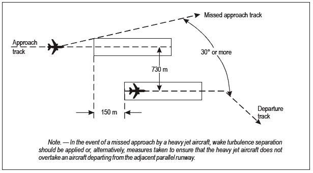

6.7.3.5.2 The minimum distance between parallel runway centre lines for segregated parallel operations may be decreased by 30 m for each 150 m that the arrival runway is staggered toward the arriving aircraft, to a minimum of 300 m (see Figure 6-2) and should be increased by 30 m for each 150 m that the arrival runway is staggered away from the arriving aircraft (see Figure 6-3).
http://www.servetbasol.com/Articles/ucu ... el-6-1.jpg
Figure 6-1. Segregated parallel operations (see 6.7.3.5.1 b))

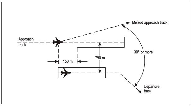

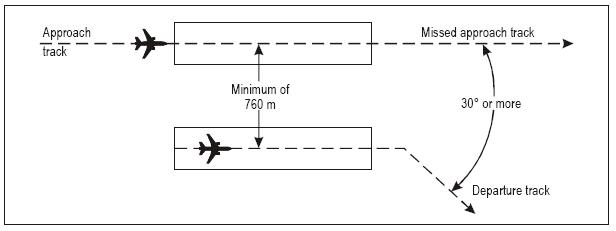

http://www.servetbasol.com/Articles/ucu ... el-6-2.jpg
Figure 6-2. Segregated parallel operations where runways are staggered (see 6.7.3.5.2)
http://www.servetbasol.com/Articles/ucu ... el-6-3.jpg
Figure 6-3. Segregated parallel operations where runways are staggered (see 6.7.3.5.2)
